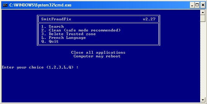

Option 1 – Search:
Double-click smitfraudfix.cmd
Select 1 and hit Enter to create a report of the infected files. The report can be found at the root of the system drive, usually at C:\rapport.txt.

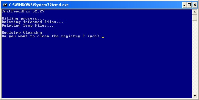

Option 2 – Clean:
Reboot your computer in Safe Mode (before the Windows icon appears, tap the F8 key continually).
Double-click smitfraudfix.cmd.
Select 2 and hit Enter to delete infect files.
You will be prompted: Do you want to clean the registry ? answer Y (yes) and hit Enter in order to remove the Desktop background and clean registry keys associated with the infection.
The tool will now check if wininet.dll is infected. You may be prompted to replace the infected file (if found): Replace infected file ? answer Y (yes) and hit Enter to restore a clean file.
A reboot may be needed to finish the cleaning process. The report can be found at the root of the system drive, usually at C:\rapport.txt.
