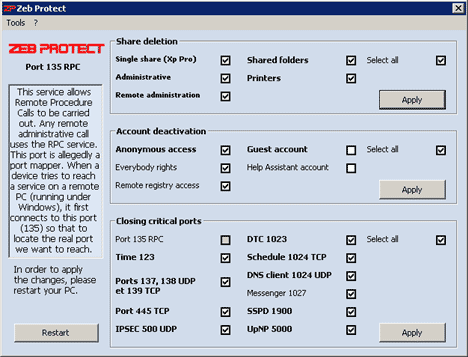

Main Tab
The main tab is made up of four parts :
- Quick Help : gives a quick glance at every options once the mouse cursor goes over it.
- Share Deletion : deletes the default shares found under Windows.
- Account deactivation : deactivates the hazardous accounts.
- Closing critical ports : closes the services which "listen" to some specific ports.
Main tab in Zeb Protect
Click on picture to increase
The software automatically ckecks if some options have already been enabled by ticking the specific boxes. You can choose your own options by ticking off the relevant boxes. Some of them are only available if the file system is NTFS.
Once you chose your options, go to Apply button, the software will prompt you to restart the system so that to modify the system..
Port 135 :
Make sure to close the other ports prior to closing port 135.
This service allows Remote Procedure Calls to be carried out. Any remote administrative call uses the RPC service. This port is allegedly a port mapper. When a device tries to reach a service on a remote PC (running under Windows), it first connects to this port (135) so that to locate the real port we want to reach. Then it will directly "talk" with the wished port.
Windows suffered from several flaws, and a couple of worms like Blaster used this port so we highly recommend to close it.
This option will forbid any access to port 135 so that to make it unreachable from the remote network (Internet), we could only use it locally in the local loop (127.0.0.1).
