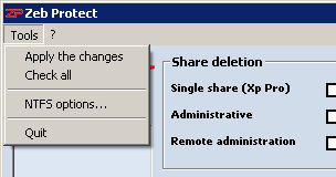

The software opens on the Main tab. In order to get all the options, go to the Tools menu :
Tools menu in Zeb Protect
Apply modifications : allows you to apply all the modifications you did within one click
Check all : re-checks all the boxes and re-establishes the previous values

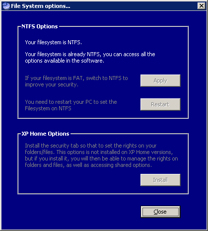

NTFS Options : the window “NTFS Options” is made up of 2 parts :
Files System options in Zeb Protect
NTFS Options : this option unlocks some options. If your system was formatted using the FAT32 file system, the conversion option to NTFS file system is then available, you only have to click on the button “Apply” to validate the new parameters. You will then be prompted to restart your PC to apply the option.
XP Home Option : this functionality is only available under XP Home operating system, you could install it only if you have downloaded the file HomePack.zip. This feature installs the “security” tab which can’t be naturally found.
Install the security tab for XP Home
Once you have clicked on the Install button, the process will ask you to replace one file : answer YES to get the English version, you will then be asked to restart your system. Once restarted, you could access the Security tab within the properties of any folder/file as well as the software’s Share deletion options.
If your file system is already set to NTFS, the software will recognize it and the option will be greyed out, as well as the security tab option found under XP Home.

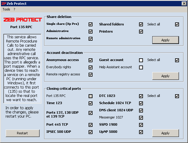

Main Tab
The main tab is made up of four parts :
– Quick Help : gives a quick glance at every options once the mouse cursor goes over it.
– Share Deletion : deletes the default shares found under Windows.
– Account deactivation : deactivates the hazardous accounts.
– Closing critical ports : closes the services which “listen” to some specific ports.
Main tab in Zeb Protect
The software automatically ckecks if some options have already been enabled by ticking the specific boxes. You can choose your own options by ticking off the relevant boxes. Some of them are only available if the file system is NTFS.
Once you chose your options, go to Apply button, the software will prompt you to restart the system so that to modify the system..
